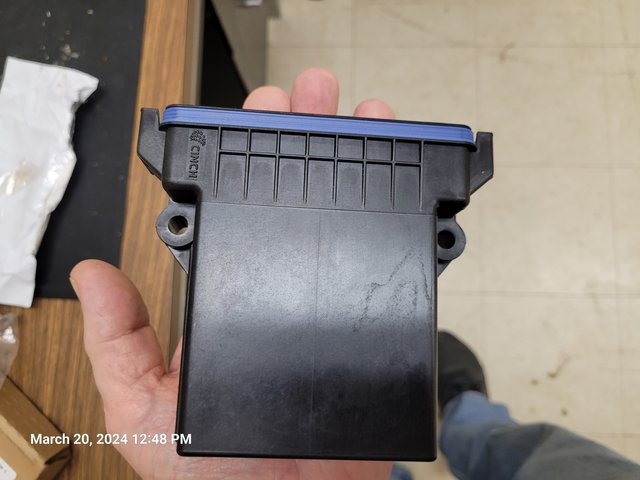

I couldn't resist buying a copy of the enclosure for motivation. I like it. Every VeeCU electronic component is extended temp range. I intend to install the unit forward of the firewall. This enclosure is just about perfect for that purpose.
Just the right size. The right number of pins. Optional ferrites on all pins. Optional vent with "hydrophobic" membrane. Very tight/nice seal. Very affordable with sealed mating connectors.
Anyway, if you can't tell, I'm get'n stoked. The user interface (i.e. switch reads and de-bounce, LED flash patterns etc. ...) is as far as I can go on the bread board. Software is just about ready to hook up to a real engine for "FMEA". It's gonna be fun :-) The schematic is complete and layout is under way.
The Design Engineer did this just to get an idea of how crowded, or not, the board will be. Not all components dragged on yet, most notably the IGBTs for ignitiion drive, but it's not going to be bad.
